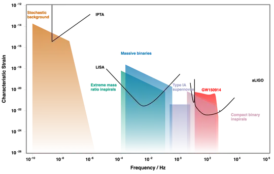

These limitations are summarized in this plot of GW sensitivity curves from http://gwplotter.com/. GW sensitivity curves and sources The black curves show the strain sensitivity of each experiment. Any GW source producing a strain greater than the curve is detectable.

The sensitivity curve for the IPTA in the plot is not terribly detailed, but it does show two important limitations (although there are other ones not shown).
At the low frequency end it goes straight up. This represents the finite length of the observation times. To measure a signal with a period of one year, you need to watch for at least one year. Since PTAs have only been gathering dedicated high precision pulsar data systematically for about 15 years (NANOGrav started in 2004), that means there is a hard low frequency cutoff at $f \sim 1/15\,\mathrm{yr} \approx 2\times 10^{-9}$ Hz (the second "N" in NANOGrav stands for nanohertz).
At the high GW frequency end the slope is determined by white radiometer noise in the radio telescopes that observe the pulsars. This sensitivity curve assumes the models for the expected time of arrival of the pulses are perfect, and any deviations from the actual time of arrival are all caused by measurement uncertainty in the radio telescopes (or GWs). This is similar to photon shot noise. The individual pulse brightness and the regularity of their shape are key factors for this effect.
In reality the expected time of arrival predictions are not perfect, so we would expect the sensitivity to bottom out and curve up again, like the LIGO and LISA curves, before hitting the low frequency cuttoff. If we mismodeled the motion of the Earth or the pulsar that's the same as having an unknown force shaking the detector test masses, adding low frequency noise.

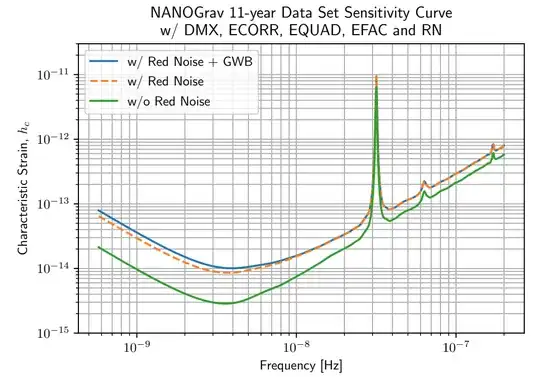

This paper by Hazboun (et al) does the messy work to calculate a much more realistic sensitivity curve for NANOGrav's 11 year dataset. It takes into account all of the individual model details and noise properties for more than 30 pulsars.
NANOGrav 11yr sensitivity, Hazboun+2019, figure 15 The green curve here is a more realistic version of the black IPTA curve in the original sensitivity plot above. The spike in the curve occurs at a frequency of $f=1\,\mathrm{yr}^{-1}$. The Earth's motion around the Sun limits a PTA's ability to measure that particular frequency.
