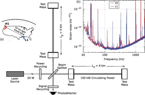

The top panels show LIGO's strain measurement, or fractional change in length $\Delta L/L$, for each detector after it has been "whitened". To whiten the data it is essentially divided by the average noise. This is kind of like a bandpass filter which suppresses frequencies where the instrument is not sensitive. The detectors' noise spectra are shown in Figure 3b of the same paper (below).
To compare the data between the two interferometers one must account for the fact that the detectors are not colocated, nor are they oriented exactly the same.
Figure 3: Simplified diagram of an Advanced LIGO detector (not to scale), with noise spectra, and geographical locations
Figure 3a of the same paper, shows the location of each detector in the USA and the orientation of the detector arms. The time shift accounts for the finite signal travel time for the GW to pass from one detector to the other. The inversion is a phase shift of $\pi = 180^\circ$ in the GW waveform, which results from the flipped orientation of the two detectors. The orientation isn't perfectly flipped, so the actual phase shift isn't quite $\pi$, but it's pretty close.
