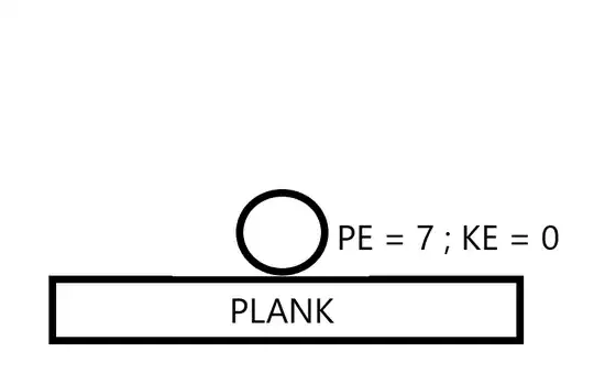

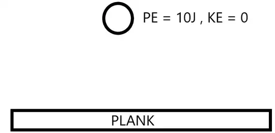

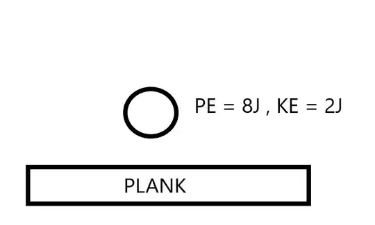

Suppose a ball is falling from a high point and we stop it midway using a plank.
enter image description here enter image description here enter image description here
Now the plank only affected the KE and total energy of the ball but not its PE.
The same way, resistance is a physical obstruction to the path of an electron which slows it down and is losing its kinetic energy but its potential energy should remain unaffected.
Now voltage is the measurement of the potential energy at a point.
Then why do we say there is a voltage drop across a resistor when the potential should be the same at both points (across the resistor)?

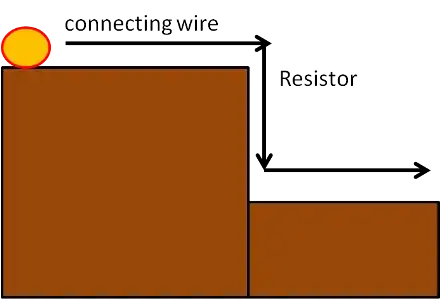

Imagine one of those marble drop game made with a lot of tiny obstacles. If you drop the marble gravity will make it accelerate downwards until it will hit an obstacle. After hitting the obstacle it will have a different velocity, but The gravitational field will draw it downwards again until it hits the next obstacle and so on ... In this path the gravitational potential energy of the marble will decrease because it is moving on average from an higher to a lower point.
In a similar way electrons flow in a resistor under the effect of the electric potential. If the potential were the same at the extremities of the resistors there would not be any movement of the charges.

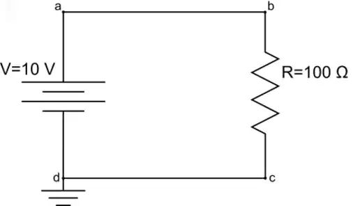

Let's take a circuit. enter image description here
Consider the loop AB, there is 0 resistance. By ohm's law (formulated much before we came to know that electricity is particulate in nature) the potential difference is 0.
So, there is no change in height when the ball is moving from A to B.
But, between B and C, as you have a resistor, the potential difference is non-zero, therefore, there is a drop in "height" and the ball falls. Once it has crossed the resistor, the potential difference between Cand D is once again 0. So, the ball doesn't lose kinetic energy.
In your assumption, you have the ball falling even when it is moving through a conducting wire, where the potential difference is zero. While moving between two points of same potential, the electron in your analogy is losing potential energy.
