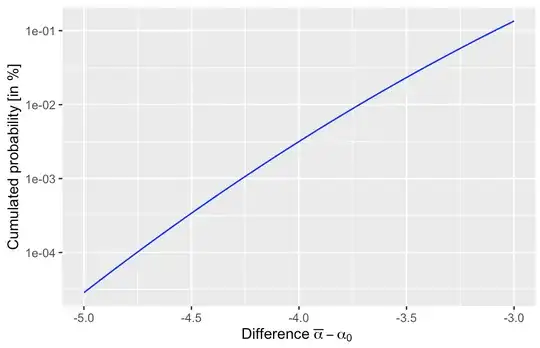

An inherent property of a measurement is that it scatters. Hence, if we take a sample containing $N=100$ data points, each measuring the same thing (=your fine structure constant), we obtain probably 100 different values. Thus, the natural question to ask is, which one is the correct measurement or is there a better way to obtain the "true" value? Generally speaking, the average value is a "good" estimator of the true value.
Skipping the details, we are (most often) allowed to say, that the average value is normally distributed. If the standard deviation of a single measurement is $\sigma_\epsilon$ and we take $N$ independent measurements, then the "uncertainty" (=standard deviation) of the mean value is $\sigma_\epsilon/\sqrt{N}$. Hence, by taking more and more measurements, we can reduce the uncertainty -- assuming that we do not include a systematic error in our data.
Finally, your question is about the confidence of your measured result. Suppose your measured average value is $\bar{\alpha}$ and you like to know how confidence you should be, that the literature value $\alpha_{0}$ is incorrect. Well, you can ask the following question: Suppose the literature value is correct, but my experimental uncertainty (standard deviation) is $\sigma_\epsilon$. What is the probability that I measure a value which is at least $k$ standard deviations smaller than the literature value? The answer is given by the so called cumulated probability, cumProb where I plotted the $x$ axis in units of $\sigma = \sigma_\epsilon / \sqrt{N}$.
