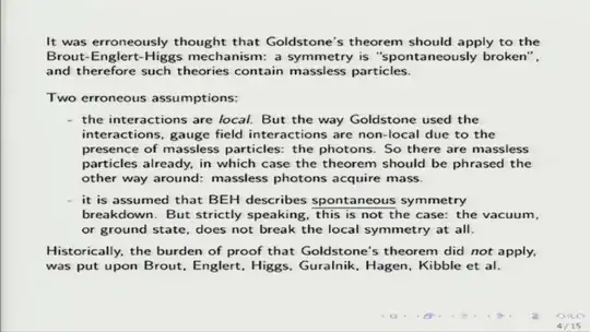

Can someone explain what makes the vacuum of a gauge theory unique, if really so? I failed to understand Prof. 't Hooft's line of reasoning. Below are two screenshots from this lecture. From the slide below, the comment about the vacuum is important

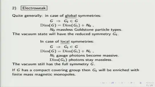

Again, the comment below regarding the vacuum of gauge theory is important

Unsurprisingly, 't Hooft's claim is correct: the ground state of the Higgs phase is unique. More generally, in any gauge theory, the ground state will be invariant(1) under all gauge symmetries (including the global subgroup).
The easiest way of seeing this, is by noting that a gauge symmetry is unphysical whereas a (ground) state is physical---and hence the former cannot affect the latter. However, it seems this argument leads to confusion, especially when it is sometimes claimed that the global symmetry is not a 'gauge' symmetry and hence can be broken. This is wrong. Fortunately, to clear up this perennial confusion, we don't even need to presume that what we are talking about a gauge symmetry. Instead, one can make the argument for general local symmetries, independent of whether or not they are 'gauge' or otherwise(2). So, for the rest of this post, I will refrain from using the words 'gauge' and rather use the words 'local' (and 'global'). More precisely, I will explain:
A theory with local symmetries cannot spontaneously break the local symmetries or the global symmetry related to it.
The first part of this claim is that we cannot spontaneously break the local symmetries. This is the content of Elitzur's theorem, and there is already a beautiful post by Dominic Else on this.
The second part of the claim is that the corresponding global symmetry is also unbroken. This is in fact an easy consequence from the previous point since the global symmetry is a special case of the local symmetry. For instance, suppose the ground state is invariant under a local gauge transformation of the particular form $$ \psi(x) \to e^{i\lambda_n(x)} \psi(x) \qquad \textrm{ where } \lambda_n(x) = \left\{ \begin{array}{lll} \theta & & \textrm{if } x \in [n,n+1), \\ 0 & & \textrm{otherwise}. \end{array} \right. $$ Then it will clearly also be invariant under doing this many times: $$ \psi(x) \to e^{i \sum_n \lambda_n(x)} \psi(x) = e^{i\theta} \psi(x), $$ which is simply a global transformation!
To say it more mathematically: the group of global transformations is a subgroup of the local transformations, and hence if we preserve the latter, we preserve the former. Any claim to the contrary is mathematically inconsistent.
It is sometimes pointed out that the subgroup of global transformations does not affect the gauge field. This is true. But that in no way implies that one can spontaneously break it (and indeed, the previous paragraph shows that it is in fact impossible).
There is another way of seeing this impossibility (which is equivalent but it might help to drive the point home): if one really claims that the global symmetry is spontaneously broken, then what is the order parameter? Any local order parameter that one would write down that is charged under the global symmetry, will automatically also be charged under the local symmetry. Hence, if such an order parameter has a nonzero expectation value, we would violate Elitzur's theorem.
