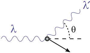

But when using Compton Scattering:
The wave will lose energy after colliding with an air particle and its wavelength will increase.
Why is there a difference? Which is right?

But Compton scattering is different. The photon energy is much higher and it physically collides with an individual atom, imparting energy to it and causing it to recoil, typically knocking an electron away and ionizing it. The photon loses that energy so, according to $\lambda=hc/e$, its wavelength must increase.
