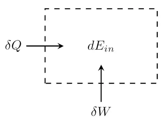

The first law of thermodynamics for a closed system
The change of the internal energy may be described using a basic conservation of energy given by the first law of thermodynamics. A closed system is able to store energy either in macroscopic external energy $E_{ex}$ such as potential or kinetic energy of the fluid flow or the aforementioned internal energy $E_{in}$. These quantities are state variables and are therefore denoted with exact differentials.
First law for a closed system with negligible external forces
For a closed system (no mass transport) the energy can only be changed by the work $W$ and heat $Q$ transferred to the system, which generally depend on the exact process path and therefore are denoted by partial differentials. The most common type of work is the expansion of the corresponding control volume against the surrounding pressure $p$ that can be calculated to $\delta W_V = - p \, dV$. Therefore for a closed system the following energy budget must hold:
$$ \delta Q + \delta W = \underbrace{dE_{in} + dE_{ex}}_{dE} \tag{3}\label{3}$$

Combining the first law of thermodynamics for a close system (equation \eqref{3}) with the differential of the internal energy (equation \eqref{2}), neglecting changes due to the external energy (see the figure above), yields
$$ \delta Q \underbrace{- p \, dV}_{\delta W_V} = \left( \frac{\partial E_{in}}{\partial T} \right)_V dT+ \left( \frac{\partial E_{in}}{\partial V} \right)_T dV. \tag{5}\label{5}$$
