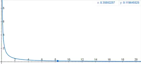

Because any function that drops off as $1/r$ asymptotically approaches $0$.
