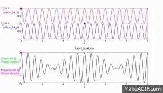

The top two graphs from the MakeaGIF.com website are for waves of one frequency/wavelength travelling at different phase speed as shown by the motion of the red and blue dot sitting on top of a crest.
The term phase is used because you are observing the particle which make up the medium at their maximum upward excursion from the equilibrium position and the speed of that crest is measured as the distance moved by a crest divided by the time taken to move that distance.
You could have equally well chosen to follow a trough or when the particles had zero displacement or the phase $kx-\omega t = \text{constant}$.
Differentiating this expression gives the phase speed as $\left (\dfrac{dx}{dt}\right)_{\rm phase} = \dfrac \omega k$
The bottom graph is the addition of the top two graphs and you will note that a modulating envelope the peak of which as shown by the red dot travels at the group velocity where group refers to the motion of a number (group) of waves added together and $\left (\dfrac{dx}{dt}\right)_{\rm group} = \dfrac {\Delta\omega} {\Delta k}$.
This is derived from French's cosine term where you want the term in the bracket to be a maximum with $\omega = \omega_1-\omega_2$ and $\Delta k = k_1- k_2$ and follow the movement of that maximum.

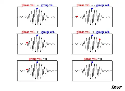

Hopefully the gif animations below from the Institute of sound and Vibration Research (isvr) will help you to differentiate between group velocity and phase velocity.
