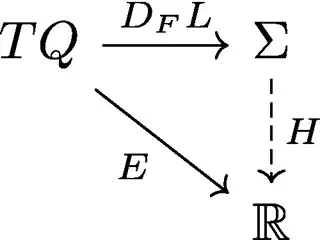

Consider a configuration space $Q$, with coordinates $q$, and its corresponding velocity space $TQ$, with coordinates $(q,\dot{q})$. Given a Lagrangian $L:TQ\rightarrow\mathbb{R}$, we have its fibre-wise derivative $D_FL:TQ\rightarrow T^*Q$. In coodinates, it maps $(q,\dot{q})\mapsto(q,p(q,\dot{q})=\partial L/\partial\dot{q})$. The kind of systems we are interested in are precisely those in which the image of this fibre-wise derivative is a regular submanifold $\Sigma\subseteq T^*Q$.
Now, on $TQ$ we have an energy function $E:TQ\rightarrow\mathbb{R}$, given in coordinates by $$E(q,\dot{q})=\frac{\partial{L}}{\partial\dot{q}^n}(q,\dot{q})\dot{q}^n-L(q,\dot{q}).$$ We may then ask whether there is a corresponding Hamiltonian function $H:\Sigma\rightarrow\mathbb{R}$. In other words, whether such a function exists such that the following diagram commutes.
Of course, this function exists if and only if for any two points in velocity space $(q_1,\dot{q}_1)$ and $(q_2,\dot{q}_2)$, whose image in the constraint surface is the same, have the same energy. Having the same image on the constraint surface means that the velocities are attached to same point $q=q_1=q_2$ in configuration space and the corresponding momenta are equal $p(q,\dot{q}_1)=\frac{\partial L}{\partial\dot{q}}(q,\dot{q}_1)=\frac{\partial L}{\partial\dot{q}}(q,\dot{q}_2)=p(q,\dot{q}_2)$. In particular, consider two such points which are infinitesimally close. From the computation on the question, we have that for arbitrary variations $$\delta E(q,\dot{q})=\dot{q}^n\delta p_n(q,\dot{q})-\frac{\partial L}{\partial q^n}(q,\dot{q})\delta q^n.$$ In particular, for the variation between $(q_1,\dot{q}_1)$ and $(q_2,\dot{q}_2)$, we have $\delta q=\delta p=0$, and thus the energy is invariant. Assuming this result can be integrated for any two points in velocity space, we conclude that indeed our Hamiltonian function exists on the constraint surface.
In coordinates, this means we have our function $H(q,p(q,\dot{q}))$. If we now want to extend this to a function on all of $T^*Q$ (or really on the corresponding coordinate patch), we might as well just consider the function $H(q,p)$ for arbitrary values of $p$ (allowed in the chart).
