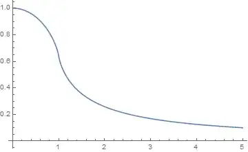

In the disk’s plane where $z=0$, the integral gives a function of $\rho$,
$$\varphi(\rho,0)=2\pi k_e\sigma a\left\{ \begin{array}{ll} \frac{2}{\pi}E\left(\frac{\rho^2}{a^2}\right), & \rho<a \\ \frac{2}{\pi}\left[\frac{\rho}{a}E(\frac{a^2}{\rho^2})+\frac{a^2-\rho^2}{a\rho}K(\frac{a^2}{\rho^2})\right], & \rho>a, \end{array} \right.$$
where $K(k)$ and $E(k)$ are complete elliptic integrals of the first and second kind.
This can be shown to have infinite slope at $\rho=a$. However, this is not particularly obvious when graphing the potential, which looks like this, where the horizontal axis is $\rho/a$ and the vertical axis is in units of $2\pi k_e\sigma a$:
One can also see that the field is infinite by computing the gradient of the potential inside the integral. That procedure produces for $\rho=a$ and $z=0$ an integral involving Bessel functions which is divergent.

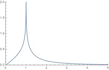

One finds that the field in the $z=0$ plane is given by
$$E_\rho=2\pi k_e\sigma a\left\{ \begin{array}{ll} \frac{2}{\pi\rho}\left[K(\frac{\rho^2}{a^2})-E(\frac{\rho^2}{a^2})\right], & \rho<a \\ \frac{2}{\pi a}\left[K(\frac{a^2}{\rho^2})-E(\frac{a^2}{\rho^2})\right], & \rho>a \end{array} \right.$$
The function to the right of the brace looks like this, where the horizontal axis is $\rho/a$:
The divergence at the rim is because $K(1)$ is infinite.
