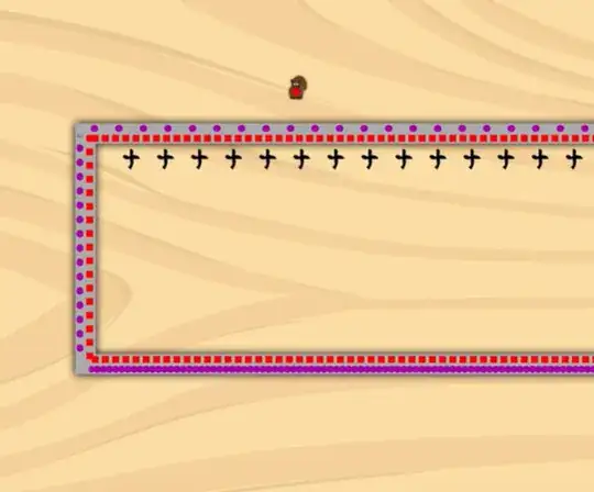

What I think I understand from this picture of relativistic charge distribution is that while the positive charges on the squirrel (or cat's) side of the wire are now contracted since the electrons are stationary relative to the squirrel, on the opposing side, the electrons are now moving at twice the speed of the positive charge in the opposing direction, resulting in ... a net negative charge, right? But if the positive charge is contracting due to moving at the speed of 1x, and the electrons are contracting due to moving at the speed of 2x, (with x being the speed of squirrel), then are we not back to where we started with a neutral wire if we subtract 1x from each??? (Am I assuming that length contraction is linear? Did I just change reference frames? Is it both?)
wire with charges on opposing ends

Why do the electrons stretch when they start flowing? Would that not make one side of the wire charged? Once again, it's not possible for all the electrons in a closed loop to stretch without bunching up at some point.
I do see that the previous answer encourages you to think this way, but I would not think this way. Basically, in order to apply relativistic concepts you have to know the situation in one frame. Once you know the situation in one frame then you can transform to another frame to find the situation in that frame.
So in the case of a wire we know through circuit theory how things are in the rest frame of the battery. We know that the wire is carrying current and that it is uncharged. That is our given information.
There is no mystical reason that it has to be that way, we have set it up that way by design. If we wanted to have the wires not carry current then we could remove the battery, and if we wanted the wires to be charged then we could have attached the whole thing to a Van de Graff generator. So by our setup we have chosen the scenario in the rest frame of the wire to be that the wire carries current and is uncharged.
With that given information in the circuit’s rest frame we can then calculate the scenario in any other frame using relativity. The charge density and the current density form a four-vector, meaning that charge density has the same relationship to current density as time has to space. So in the circuit frame, assuming the current is going counter clockwise, then the current density four vector in the top wire is $(\rho,j_x,j_y,j_z)=(0,-j,0,0)$, in the left wire is $(0,0,-j,0)$, in the bottom wire is $(0,j,0,0)$ and in the right wire is $(0,0,j,0)$.
Now, with that information we can easily transform to any other frame. For example, in a frame moving at $v$ with respect to the circuit we get the current density four vector in the top wire is $$\left( \frac{jv}{\sqrt{1-v^2}},-\frac{j}{\sqrt{1-v^2}},0,0\right)$$ the bottom wire has opposite sign from the top wire and the left and right wires have the same current density four vector as in the circuit frame.
So, with this we notice a couple of things. First, in the moving frame there is a sort of “current density” contraction similar to length contraction. We also notice that there is a non-zero charge density. As you mentioned:
That is correct. We see the opposite charge density on the opposite wire. So we do get the bunching and spreading necessary to conserve charge. This approach helps us understand your final question:
assuming that the electrons due stretch for some reason when current flows through them, isn't it incredibly convenient that "this stretching is exactly canceled out by the length contraction"?
Basically, we see that this is a little backwards. The fact that the charge density is zero in the circuit frame is the given. It is provided by our experimental setup. There is no “convenience” about it, we simply chose it by our setup.
What is a result of our setup in the circuit frame is that in the moving frame there is a nonzero charge density. That is a direct result of transforming the defined circuit into the moving frame. It is not merely a coincidence that the charge in the moving frame cancels out the length contraction, but instead the experimental setup mandates there be no charge in the circuit frame and then the charge in the moving frame is a result.
