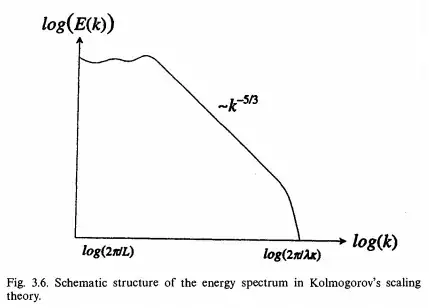

Wavenumber Space Representation: Later in the text, Doering & Gibbon go into the enstrophy and energy in wavenumber space (starts at 52, but if you're not already familiar with turbulence and wavenumber space, I'd suggest going through the whole chapter. Not that long, not too dense). tl;dr on wavenumber space is higher wavenumber = smaller length scale and vice versa.
To summarize that section, energy distribution in wavenumber space takes on the "classic" turbulence cascade, with the Kolmogorov-Obukhov 5/3 law showing off beautifully: energy cascade turbulence

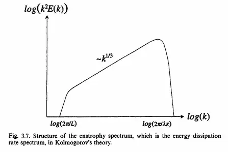

There also exists enstrophy distribution in wavenumber space, where dissipation takes on larger values as the wavenumber increases (ie. at smaller length scales). This corresponds to the decrease in energy found in the $E(k)$.
Enstrophy cascade
As you an see, Doering & Gibbon give enstrophy in wavenumber space as $E(k)k^2$. They don't give any derivation or explanation behind it. I have only a few ideas of how it is true, but they're not very concrete (lots of "hey, this term looks like this term").
