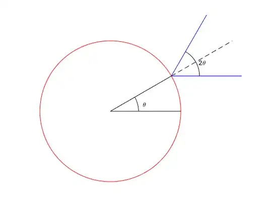

I didn't understand this at first so I thought I would write up a quantitative explanation. Suppose a light beam with intensity $I$ is incident from the right on the surface of a sphere and consider what happens to light that hits an an angle $\theta$ from the leading point of the sphere:
fig 1
The incident light carries momentum $$\Delta p_x=-\frac Ic\cos\theta\,d^2A$$ In the $x$-direction, where $d^2A=R^2\sin\theta\,d\theta\,d\phi$ is the areal element on which the light is incident and $c$ is the speed of light. The factor of $\cos\theta$ is there because the areal element is inclined at angle $\theta$ to the incident beam. As can be seen in the figure above, the reflected light carries momentum $$\Delta p_x^{\prime}=\frac Ic\cos2\theta\cos\theta\,d^2A$$ Thus the change in momentum of the sphere is $$\Delta p_x-\Delta p_x^{\prime}=-\frac Ic(1+\cos2\theta)\cos\theta\,d^2A$$ Adding this up over the front face of the sphere we get $$\begin{align}F_x&=\int_0^{2\pi}\int_0^{\pi/2}-\frac Ic(1+\cos2\theta)R^2\cos\theta\sin\theta\,d\theta\,d\phi\\ &=-\pi R^2\frac Ic\int_0^{\pi/2}\left[1+(\cos2\theta)\right]\sin2\theta\,d\theta\\ &=-\pi R^2\frac Ic\left[-\frac12\cos2\theta+\left(-\frac14\cos^22\theta\right)\right]_0^{\pi/2}\\ &=-\pi R^2\frac Ic\left[1-(0)\right]\end{align}$$ So with or without reflection I am getting $$F=\frac{\pi R^2I}c$$ To the left as the force on the sphere due to the light beam.
As to intuition: if the above picture were for a cylinder, reflection would increase the force by $33\%$ compared to absorption. I had thought that it might have been related to the fact that a slice of a sphere of radius $R$ of thickness $h$ always has $A=2\pi Rh$ of the original surface, no matter where the slice was taken, but looking at the above derivation we can see that it's a completely different phenomenon.
