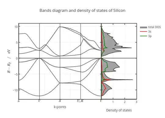

The integrals in semiconductor physics usually have a factor of density of states $\rho(E)$ which goes to zero outside certain energy limits. So you can integrate to infinity, but the density of states will only be non-zero for certain ranges.
Mathematically then, if you want to integrate a function $f(E)$, you are replacing a sum over energy states by an integral times the density of states.
$$\int_{-\infty}^{\infty} \rho(E) f(E) dE \leftrightarrow\sum_{E_i} f(E_i)$$
You can see the density of states below from this link. For silicon the relevant bands span about 20 eV.
