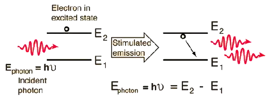

This type of "resonance" is described mathematically in the link, and pictorially:
stimem
