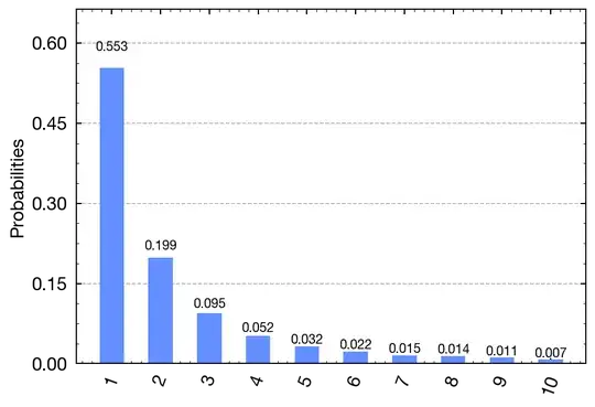

Comparing the expression for the error in Eq. (15) with a simulation:
Simulation
We find that $(\pi/4)^4\approx0.38$, $(\pi/8)^4\approx0.024$. Thus, something is wrong.
