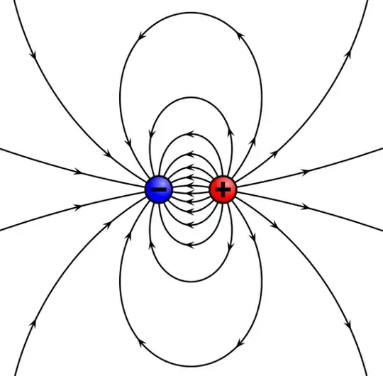

Let's call the charge density before bringing the other plate $\sigma$. The new charge density after bringing the other plate is $\sigma'=2\sigma$. Why can't we superimpose the two fields in the second scenario?
If we have a positive charge near a negative one, here too the negative charge acts as a "terminator", yet the total field is the sum of the fields produced by the two charges, not just one. enter image description here

I agree with your assessment. The mistake David makes is assuming that since all of the charge moves to one side of the plate that the field on one side of the plate doubles and the field on the other side goes to $0$ due to that plate. Even when the charges all move to one side, the field on each side of the plate is still $\sigma/2\epsilon_0$. Then you would still add the two fields together.
The reason the offset of the charges doesn't change anything is because we have assumed infinite sheets of charge so that the field does not depend on the distance from them. Therefore, suggesting that the horizontal translation of charges produces different fields that do not superimpose appears to be incorrect. David's explanation is correct if you have already done the superposition (then you do have $0$ field outside and $\sigma/\epsilon_0$ inside with field lines starting on positive charges and ending on negative charges).
