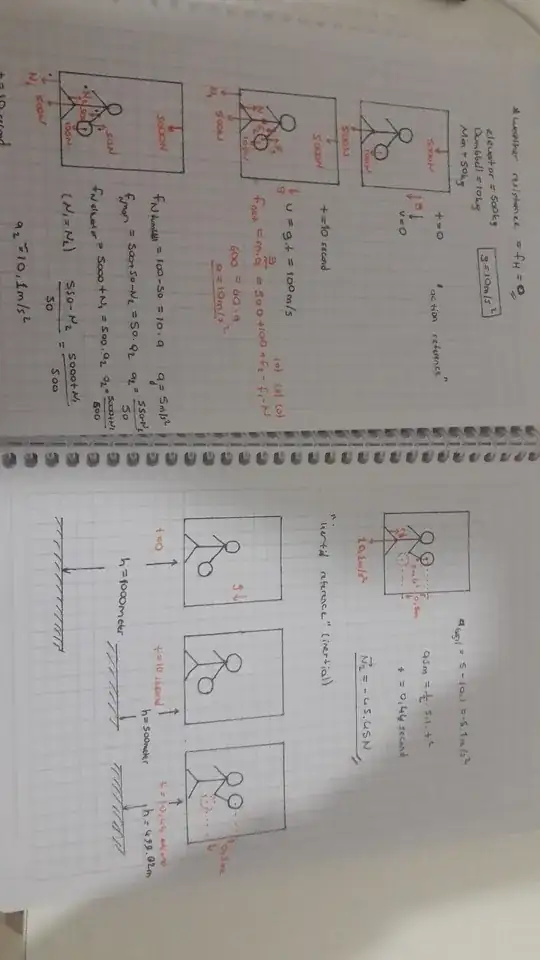

Free fall is falling with the acceleration of gravity. Therefore, the person inside the elevator does not feel his weight while holding the dumbbell (unless a force is applied). However, if it exerts a force, the dumbbell acceleration decreases. So he feels as if he is up in the elevator. However, according to the external viewer, the elevator and dumbbell move downward. I threw you these detailed force analyses. I examined it in the action and inactive reference frames.
