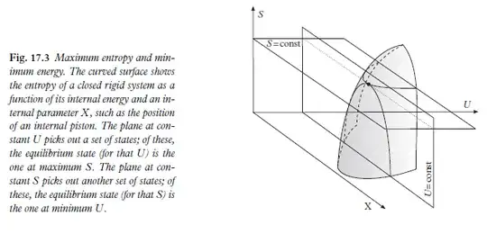

Part of the reply by Andrew Steane points to an answer (in the legend of his Fig. 17.3). Yet, on the other hand, I don’t feel that the demonstration that follows is fully appropriate or that it correctly addresses the issue (for example, the maximum entropy principle does not apply to a system that is not isolated).
An important thing to understand (often a source of misconception) is that each point of the curve of Fig. 17.3 represents the entropy of a system at equilibrium for different constrained values of some internal parameters. As a consequence, plotting a "trajectory" on such a curve doesn't actually define any specific process, it just represents "loci of equilibrium states" to borrow the words of Herbert B. Callen.
To be concrete I will take the nice example in the legend of Fig. 17.3 from Andrew Steane: a cylinder filled with an internal piston and some gas in each compartment. Assume the cylinder to be of constant volume and with adiabatic walls. If the position of the piston is changed reversibly, the entropy of the system stays constant. Now, whether the piston itself is adiabatic or not won’t change the following reasoning, but for simplicity I will fist assume that the piston is adiabatic; I will come back to the diathermal case afterwards.

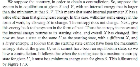

This is figure 17.3 from Thermodynamics, a complete undergraduate course by myself (Steane), published by OUP (2016). Here is what I hope is an intuitive argument.
For a $pV$ system, consider the situation at given $S$ (the volume $V$ being also fixed). Let $X$ be an internal parameter. The states at various $X$ have different internal energies to one another. Of these states, the one with the least internal energy is the equilibrium state when the system has the given $S$.
Proof:
Andrew Steane
