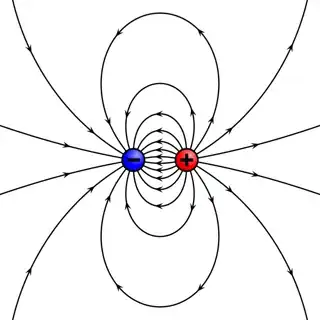

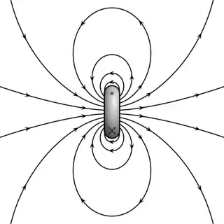

Further, the magnetic field inside the dipole system is opposite in direction when compared to that of a circular loop. This can be inferred in the central regions in the following diagrams:
Left: Magnetic field due to a current carrying circular loop.
Right: Magnetic field due to positive (north) and negative (south) magnetic charges (magnetic monopoles) separated by some distance (magnetic dipole).
Image source: Magnetic dipole - Wikipedia
It can be seen that the magnetic field lines are similar in both diagrams except in the central region where the directions are opposite. Also, the field at the assumed pole cannot be determined by using Coulomb's law of magnetism as $r=0$ in $\frac{\mu_0}{4\pi}\frac{m}{r^2}$. However, it can be easily calculated using Biot-Savart law.

  1. Is the magnetic dipole picture of assuming a circular loop carrying a current is a kind of "approximation"? Or in other words, is the field determined by assuming magnetic fields due to magnetic monopoles different from the original field due to circular loop?
Yes. For example, as you can clearly see in the figure, the two fields don't even point in the same direction in the interior.

  1. Does the pole picture causes variation only in the direction or also includes difference in the magnitude of the field?
Yes. For example, as you can see from the figure, the magnitudes diverge at the poles and at the loop, and there's no corresponding divergence in the other picture.
