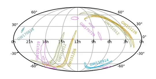

A two interferometer array like LIGO can use the time delay between the two detectors to localize a source to a ring on the sky. Because of uncertainty in the measured time of arrival, these rings are broadened a bit. Because the two detectors aren't quite coplanar, they are not equally sensitive in all of the same directions. The relative amplitude observed in the two detectors can further help the sky localization. This is why some point of origin sky maps show two disconnected pieces of the same ring. The bigger the amplitude of the signal, the easier it is to detect this amplitude difference.
GW localization map for half of the events in GWTC-1
In the sky localization summary above from LIGO/Virgo's first gravitational wave transient catalogue (GWTC-1) you can see these effects. GW151012 and GW151226 both have disjoint ring segments. The higher amplitude GW150914 has a single ring segment. The higher amplitude signal carries more relative amplitude information when you compare the signal from the two detectors.
GW170818 was detected by both LIGO detectors and Virgo in Italy. This signal can be fully triangulated to a single point (smudged out due to the time of arrival uncertainty).
