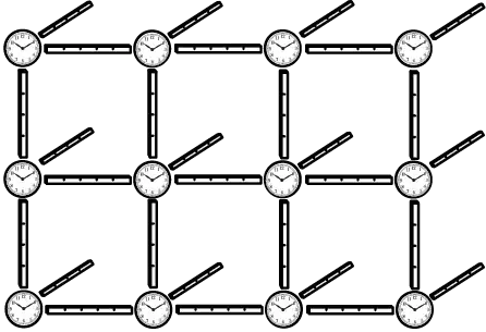

It is my understanding that, in special relativity, any event in $4D$ spacetime may be described in any reference frame (except in degenerate cases such as when acceleration generates an event horizon). That is, if the coordinates of some event are known to be $(\mathbf{x}, t)$ in some frame $S$, then there almost always exists a transformation $\mathbf{x}'(\mathbf{x}, t)$, $t'(\mathbf{x}, t)$, which expresses the coordinates in some other frame $S'$ in terms of those in $S$. In this way, a reference frame in SR is made up of a rigid structure throughout all of space, which has a clock affixed to every point - this allows the coordinates of every event to be measured.
SR reference frame
