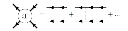

Consider 4-fermion theory with contact attractive interaction $g$. Then consider temperature Green functions and non-crossing approximation. It means that vertex function is given by infinite ladder, enter image description here
Performing summation of geometric series, one can find the following expresstion for vertex function, $$\Gamma_q=g+\frac{gT}{V}\sum_{p}\Gamma_qG_{p+q}G_{-p}.$$ In this notation, $q=(i\omega,{\bf q})$. Performing summation over Matsubara frequencies, we find $$\int_p\frac{n_F(\xi_p)-n_F(\xi_{p+q})}{i\omega_n-\xi_{p+q}-\xi_p}\approx \nu_F\ln\frac{\omega_D}{T},$$ which indicates to Cooper instability. Our approximation about contact interaction relates to the phonon propagator.
