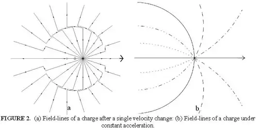

A figure of the field lines of a constant accelerating charge from Charge Acceleration and Field-Lines Curvature is
enter image description here Robert Shuler talks about this figure in the thread Is the principle of equivalence, the starting point of general relativity, a correct assumption?:
"You can see that for uniform acceleration, none of the classic features of radiation can be identified. In particular, since no point is clearly distinguishable from another point, no frequency is identifiable. Effectively, the frequency is zero."
A try at a theory: The smooth constant acceleration field lines do not radiate, but store potential energy like a compressed spring. A change in acceleration releases the energy in the form of radiation.

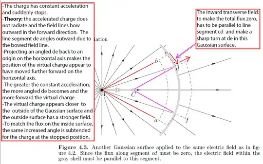

Modifying a derivation from Magnetism, Radiation, and Relativity by Daniel V. Schroeder Chapter 4, p.30. Figure 4.3
