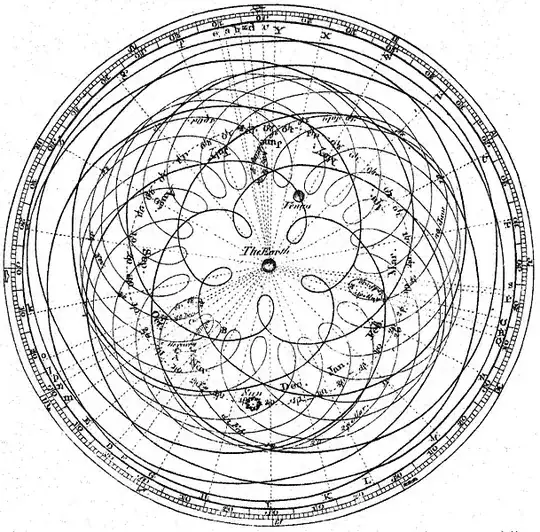

You are talking about the geocentric model and that model has very complicated orbits of planets around the earth. Here have a look at the orbits of planets around earth:
Geocentric Model
So why not just use the simpler one in which all planets revolve around the barycenter of the solar system.
Also a point to note is that a model with earth at the center of the solar system is not inertial so Newton's laws of motion wouldn't work without a centrifugal force which only adds to the complexity of the case.
