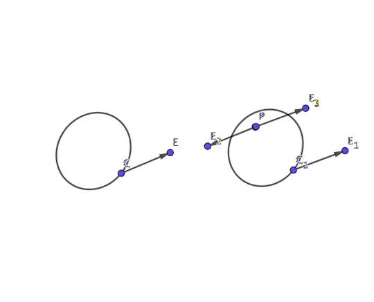

You can choose whatever point of the body you like. Once you have chosen one point of the body, for each force acting on different points, you can add a pair of opposite forces, acting on the selected point, of the same modulus as the selected force. The force opposite to the original one will form with it a pure torque. All the members of the pairs with the same direction as the original applied forces will have the same application point and you may sum them according to the rules for vector sum.
The final result is that on the body there will be a net force acting on the selected point plus a net torque originating from the sum of all the torques. The construction is sketched in the following drawing: enter image description here
To the original force (arrow CE) acting on C, a pair of opposite forces acting on the selected point P have been added. The resulting system is a torque created by the forces (PE$_2$) and (C$_1$E$_1$) plus a force equal o (CE) But acting on P. As I stated above, any point can be used for this procedure, although in many cases it may be convenient to use the center of mass.

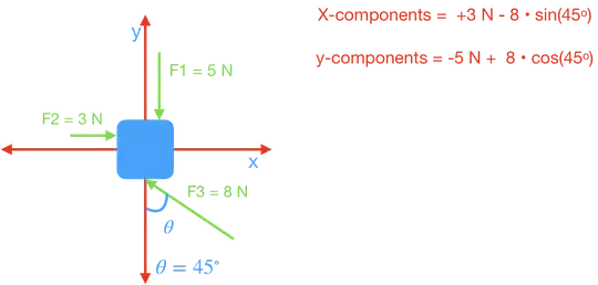

You would need to define a coordinate system and then add the force vectors coordinates for the 2 or 3 perpendicular axes of your coordinate system. In a cartesian x,y coordinate system it would be helpful to put object centered on the origin and then find all the x and y components of force. To find the actual equations of motion you'll need to solve the torque equation as well.
