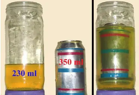

Take a look at the image* below:
The can has a volume of 350 mL, so it would theoretically displace roughly that much liquid if it were immersed, but this cannot happen because there is only 230 mL of (artificially colored) water. So, how does Archimedes' Principle account for this apparent paradox? Furthermore, why isn't this discussed more often?
(*The source for the picture is an article written in a foreign language, so I won't bother posting it. Interestingly, I could not find a similar setup on websites in English.)
"The volume of displaced fluid" doesn't mean the physical volume of fluid that has moved out of the way. (After all, as you say, that doesn't make sense if there's not much fluid.) The phrase actually means the amount of volume that the floating object takes up which is below the fluid's current level.
Since these two definitions coincide most of the time, common sources conflate the two, but the latter is what actually is used, e.g. in a derivation of Archimedes' principle in any physics textbook.
