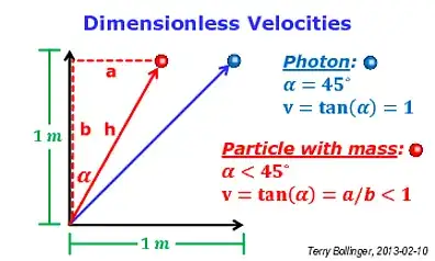

Continuing with an important point: Once you've made the conscious choice to measure time in meters, a dimensionless velocity constant is more accurately interpreted as the tangent function of an angle, specifically the angle called $\alpha$ in much of the special relativity literature.
The reason why is not hard to see. Take a look at this figure:
Dimensionless Velocities
While it sounds at times as though special relativity is all about hyperbolic spaces, when it comes to light cones, dimensionless velocities, and angles such as $\alpha$ that are just another way of expressing velocity, it's really all about traditional trigonometry and the sides of right triangles in thoroughly Euclidean spaces. The hyperbolic views come into play only through a deeper analysis of the implications of $c$ being invariant.
I have to point out a bit of conceptual dyslexia that seems entrenched in how SR and GR text represent the concept of dimensionless velocities.
Look at my earlier figure, where I showed how the SR angle $\alpha$ can be used to defined a dimensionless velocity as $tan(\alpha)$.
So, what kind of space is that figure and its right triangle $\triangle{abh}$ using?
Well, Euclidean of course, with a [++] signature. It's all just good old Pythagorean $h^2=a^2+b^2$, and that's exactly what makes the $tan(\alpha)$ definition of dimensionless velocities possible.
But think about that: Isn't time always supposed to have a different sign from space? That is, for the simplified 2D space of the figure you should have either a [-+] or [+-] signature for $t$ and $x$, but not the [++] (simple Pythagorean triangle) of the figure.
The reason it comes out [++] is that velocities are ratios, and ratios are most directly expressed by using two axes of a Euclidean space with a [++] signature.
So, if you like dimensionless velocities based on the $c$-inspired assumption that $1 m = 3.33564095 ns$, it's hard to avoid also the need for a Euclidean space with a [++] signature to express those dimensionless velocities as simple ratios. Once you allow that you get that nice right triangle with sides $a$, $b$, and $h$, angle $\alpha$, and the desired dimensionless velocity $v=tan(\alpha)$.
However, this deviation from a [-+] signature is also why no one ever bothers to give that poor, lonely hypotenuse $h$ in the figure its own name. It's not that you can't find some geometric use for $h$, it's just that $h$ is a Euclidean mix-up of $t$ and $x$. That's a bit of a bit of a no-no in the [-+...] hyperbolic world of SR. So, most descriptions use only the safer $tan(\alpha)$, which relies only on the space and time deltas $a$ and $b$.
A tendency to avoid getting too deep into [++...] Euclidean spaces is I suspect also why no single, isotropic definition of the meter (call it $m_s$) is used to explain the equivalence of $t$ and $m$, as the inquirer suggested in a comment. But it's still a handy idea. By using an isotropic $m_s$ unit of measure for all lengths in spacetime figures, the equivalences become trivial: $1 m_s = 1 m$ when looking at horizontal $xyz$ distances, and $1 m_s = 3.33564095 ns$ when looking at vertical $t$ distances. Such lengths are of course emphatically not Lorentz invariant, but then again, neither are velocities in general.
