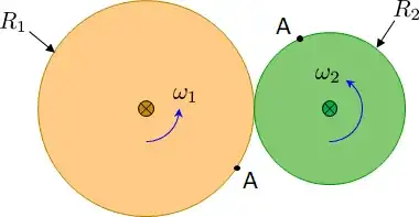

Consider two free floating disks with incompatible rotations, where a single gear tooth at point A is about to go into contact at some point in the future.
The translational and angular momentum of each part is $$ \begin{aligned} p_1 & = 0 & L_1 & = I_1 \omega_1 \\ p_2 &= 0 & L_2 & = I_2 \omega_2 \\ p_{\rm total} & = 0 & L_{\rm total} &= I_1 \omega_1 + I_2 \omega_2 \end{aligned} $$
Total angular momentum is the same regardless of point of measurement since translational momentum is zero. So we might as well measure total angular momentum about the contact point.

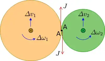

Now the contact happens when points A align. This causes an equal and opposite impulse $J$ to be acting on the two disks.
Regardless of the value of $J$, the result is not only a change in angular velocity $\Delta \omega_1$ and $\Delta \omega_2$, but also the acquiring of translational velocity of the two disk centers $\Delta v_1$ and $\Delta v_2$.
$$\begin{aligned} \Delta v_1 & = -\frac{J}{m_1} & \Delta \omega_1 & = -\frac{R_1\,J}{I_1} \\ \Delta v_2 & = +\frac{J}{m_2} & \Delta \omega_2 & = -\frac{R_2\,J}{I_2} \end{aligned} \tag{1}$$
Now the translational and angular momentum change of each part is
$$ \begin{aligned} \Delta p_1 & = m_1 \Delta v_1 = J & \Delta L_1 & = I_1 \Delta \omega_1 - R_1 (m_1 \Delta v_1) = 0\\ \Delta p_2 & = -m_2 \Delta v_2 = -J & \Delta L_2 & = I_2 \Delta \omega_2 + R_2 (m_2 \Delta v_2) = 0 \end{aligned} \tag{2}$$
So the change in total translational and angular momentum is
$$ \Delta p_1 + \Delta p_2 = J - J = 0 \; \checkmark \tag{3}$$ $$ \Delta L_1 + \Delta L_2 = 0 + 0 \; = 0\checkmark \tag{4}$$
So conservation is valid, regardless of the impulse amount.

The way to make the two disks stop, is if their centers are connected to ground. This can be modeled above with $m_1 \rightarrow \infty$ and $m_2 \rightarrow \infty$. The necessary condition for the disks to stop after impact is then
$$ \frac{L_1}{L_2} = \frac{I_1 \omega_1}{I_2 \omega_2} = \frac{R_1}{R_2} $$
