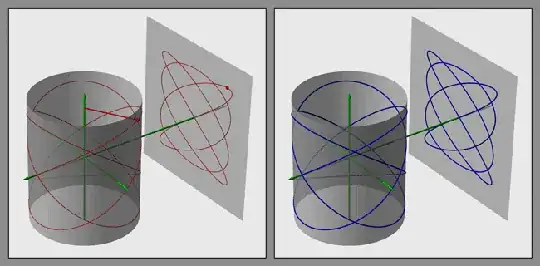

You have created a Lissajous spiral from the tea: the raising of the mixing utensil creates a partial secondary flow which deviates some of the concentric flow up and down. The continuous rotational flow dominates and it is interrupted by a group that flows up and down as well as concentrically.
The effect slightly follows a Lissajous trajectory, although it is a complex turbulent flow and would necessitate some direct observation to understand precisely.
As others have said, it's very likely that the lissajous travels downwards through the center of the mug and back upwards trhough the sides, so that it actually becomes a spiralling torus.
You can use oat flour or glitter in a transparent mug to see the effect. You can glue a syringe with milk to a spoon to see if you can observe a Lissajous spiral and film it. It probably necessitates a big jar and a video because there are a lot of small turbulent vortices that spiral and mix the boundary of the concentric vortices, especially when the Lissajous flow hits upper and lower boundaries.

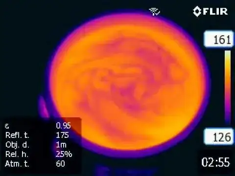

The liquid in your mug does not rotate as a solid body due to viscosity; it also goes up at the center and down at the mug walls ("rotates in a vertical cross section") due to heat losses and thus stratification effects. So the 3D motions are not stationary anyway - they will stop in a finite time. Their interplay (roughly saying, transport time and rotation time) lead to some surface effects that you observe.
The variable rotation speed is due to (semi-)turbulent motion.
You can see this more clearly in this YouTube video that doesn't show the rotation by a few bubbles but by thermal imaging (which also shows the convection).
YouTube image
https://www.youtube.com/watch?v=Va8xP2Q6sgo#t=2m00s
It is not the entire flow that changes uniformly, but instead it looks more chaotic. Medium size rapidly rotating edies occur (randomly) and dissipate their energy and dissapear after which new eddies form.
The pattern seems to occur rhythmically because it only appears like that (but it is a bit random). Although the eddies may have a narrow distribution in lifetime because the Rayleigh-Bénard convection on top of the rotation causes fluid to move inward (where liquid is cooler and sinks) which creates a consistent pattern of acceleration in the angular speed and eventual collapse of the eddie.
Note that these eddies keep occurring also when the stirring was a long time ago. They are powered by the
  • energy/motion from thermal convection (or only stirring if there is no strong temperature difference)
  • turned into eddies/rotation due to turbulence (and regular instabilities that can already be explained by laminar flow)
  • and a tornado effect because the liquid is moving to the inside (convection) which accelerates the angular speed (like the ballerina making the pirouette and explained by conservation of angular momentum)
The exact type of instabilities that cause the oscillations might be difficult to pinpoint because there are multiple effects (initial chaotic state due to stirring, temperature/gravity gradients, flow instabilities in rotating fluids, deceleration of the rotation when stirring stops). There are many visualisations of such effect (with ink or particles in liquid) an example is this YouTube video
