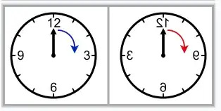

The math of parity is defined here, while the Wikipedia article about Wu's experiment provides a simple example to the topic. Consider a 2D clock (left picture) and it's mirror (right picture)
clock01

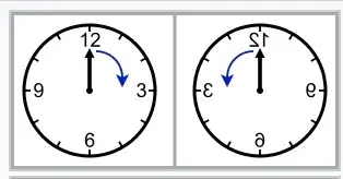

In a world which conserves parity and were a "left clock" rotates clockwise, the mirror image of the clock rotates anti-clockwise, see upper image. However, if we would observe that the mirror image of the clock rotates clockwise as well, clock02
we would conclude that parity is not conserved.
