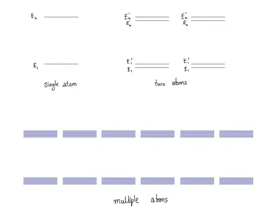

That explains the gap. But what about the continuum? Individual atoms have discrete energy states. But when two atoms come close to each other they affect each other to split energy states. This can be understood by the following cartoon:An oversimplified picture of emergence of bands
Obviously, the cartoon is an oversimplification of the actual physics but in essence this is what is causing the band (continuum of energy states) to appear. If the action of the neighbouring atom on the electron is less than that due to the current atom, the splitting of energy levels is less than the gap between the states. However if the neighbouring atom’s influence is comparable with that of the current atom, the splitting will be of the order of the gap. In this case, the two bands overlap. This is what happens in metals.

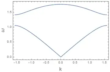

This is the way I like to think about it. You have probably encountered dispersion relations already, which tell you the frequency for a particular wavelength. Here's the dispersion for phonons (vibrations in crystals):
phonon dispersion

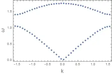

In quantum mechanics frequency and wavelength are related to energy and momentum respectively by $E=\hbar\omega$ and $p=\hbar k$. Each material has its own dispersion relation and this dispersion places constraints on the allowed energies. A free particle has dispersion $E=\hbar^2 k^2/2m$ so any energy is possible but take for example the infinite square well. There the potential forces the energies to only take on discrete values. To go back to the phonon dispersion, let's break up the dispersion so it only takes on discrete values of $k$ to make it easier to visiualize.
discrete phonon dispersion

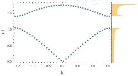

Now imagine you turn the image $90^\circ$ clockwise and let all the points fall down. If you now count how many points fell onto a particular energy you roughly see how many states are available for that energy level. This looks something like this:
phonon with histogram
For energy bands we are only interested in whether or not an energy has any available states. To get the energy band you extend the yellow graph so that it reaches all the way if has at least one state state. You basically stretch the yellow graph until it is a rectangle. For some energies there are zero states so even after this stretching it is still empty. This is a band gap.
In quantum mechanics each state can only be occupied by one particle (for fermions, which include electrons) so usually the states are filled from the bottom up. Energy and momentum conservation still apply so to excite an electron from the lower to the upper band it has to absorb an energy that is at least as large as the band gap.
