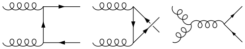

So, I am trying to understand what helicity combinations can occur in the outgoing top-antitop pair in the tree-level scattering $gg\rightarrow t\bar{t}$. There are 3 diagrams to consider (see below), an s-, t- and a u-channel.
Tree-level contributions to <span class=$gg\rightarrow t\bar{t}$">
