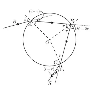

Now why would that be the case? The answer is pretty amazing: it turns out that when parallel rays of light hit a (spherical) drop, some incident rays don't deviate very far from each other, and end up bunching together. This depends on the angle that they strike the back of the drop with (known as the angle of minimum deviation -- something that might be familiar to people who have done simple experiments with prisms). Here's an example:
As you can see, the rays $e$, $f$, and $g$ in the first order rainbow (on the left) and $f$, $g$, and $h$ in the second order rainbow (on the right) pass through the drop and leave very close to each other, while the others get deviated by large angles. This 'minimum deviation' is found to depend rather heavily on the refractive index $\mu$ and the order of the rainbow $K$, and so different colours exit the drop at ever-so-slightly different angles, with each colour tightly bunched together about some angle. A series of simple but painful calculations lets us see that the angle of incidence of the rays that lead to this angle of minimum deviation is given by
$$\cos i = \sqrt{\frac{\mu^2 - 1}{K (K+2)}}.$$
Since we know that the refractive index $\mu$ depends on the wavelength of light, we see that $\mu_\text{red}=1.331$ and $\mu_\text{blue}=1.340$ (in water) cause angles of incidence of roughly $59.52^\circ$ and $59.00^\circ$ respectively.
Now you can calculate what the angle would be at the point of reflection (at the water-air interface), which you should be able to see from the above diagram should be $r$. It's trivial to calculate $r$ given $i$ and $\mu$ and show that it is less than the critical angle required for TIL ($\approx 48.75^\circ$), and so the ray can't undergo total internal reflection!
