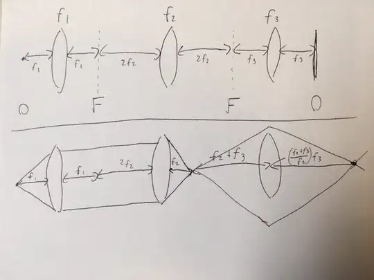

Here is a janky sketch of what I am talking about. In the upper image the $O$ and $F$ symbols denote object and Fourier Planes. In the lower image I have done a rough ray tracing of an on-axis point.

You are right that the second lens does image the amplitude of the Fourier back-focal plane of the first lens to its own backfocal plane, but it changes its phase along the way!! This means your first drawing is incorrect from the second lens onwards. To really get it right, you have include the complex transfer function of a lens $$a(x,y) \sim e^{-i\pi \frac{x^2+y^2}{\lambda f}}$$(see the notes here).
In more detail, the optical field $2f_2$ to left of the second lens is given by
$$\psi(x,y,z=2f_2) = A(x,y) e^{i\phi(x,y)}$$
At the backfocal plane ($2f_2$ to the right of the second lens), you get
$$\psi'(x,y,z=-2f_2) = A(-x,-y) e^{i\phi'(x,y)}$$
Which is to say the object undergoes a magnification of $-1$ across the second lens.
So while it is true that the intensity pattern $I(x,y) = \vert \psi(x,y)\vert^2$ at $+2f_2$ and $-2f_2$ are identical (modulo overall inversion), their phases are very different in general $\phi(x,y) \neq \phi'(x,y)$. If you send $\psi'(x,y)$ through the third lens with the full transfer function formalism, you will find that it does not result in the initial object, in contrast to your first image.
The two optical fields before and after the second lens will only be identical (modulo inversion) under "plane wave illumination" conditions where $\phi(x,y)=\mathrm{const.}$ and thus $\phi'(x,y)=\mathrm{const.}$. This is why you need a setup like that shown in Figure 1 of these notes to get the Fourier transform property to work in practice.

Ray optics and wave optics are equally able to describe your optical setup. Wave optics is just additionally able to describe effects of interference, diffraction and polarization. This makes it necessary to always consider intensity and phase when using the wave model. The phase is what you do not considered when describing the effect of the second lens which leads to an incorrect result for the wave optics approach. The Fourier transform formalism can be used to describe the connection between the wave field in the front focal plane of a lens with the wave field in the back focal plane. To get to different distances to the lens you have to calculate the according propagation of the wave field for which you have to use intensity and phase of the wave field.
The example of a simple wave field consisting of two wavefronts might illustrate what is happening in the optical system you describe:
Lets assume two point light sources in the object plane. One point light source on the optical axis and one at a distance to the optical axis. Both emit a spherical wavefront which will hit the first lens. This lens converts the spherical wavefronts to plane wavefronts (i.e. collimates the light) since the object plane is at focal distance to the first lens. The light from the second light source (the second wavefront) is a tilted plane wave after the first lens (i.e. the collimated light has an angle to the optical axis) because the second light source is not located on the optical axis. Both wavefronts do not change shape when propagating to the back focal plane of the first lens (effects of lens apertures are ignored here for simplicity). The interference pattern of two plane waves at an angle shows straight fringes of equal distance. Such sine-shaped intensity patterns are the spatial frequencies which are described by Fourier theory. (Reversing the direction of the light and the Fourier transformation shows that the off-axis spot (i.e. the second point light source) is the Fourier representation of the spatial frequency of the interference pattern.)
The two wavefronts then propagate further to the front focal plane of the second lens, still keeping their shape and direction since this is the property of plane wave propagation in free space. You can now use the Fourier transform approach to get to the back focal plane of the second lens (in principle the reverse operation as with the first lens) or use the property of lenses that they transform a plane wave to a spherical wave with a radius of curvature of the focal length of the lens. A positively curved spherical wavefront converges to a point at its center of curvature. Either way you get two light spots at the back focal plane which are the images of your object as you already showed with the ray model and the image formation formula.
beam paths
At the position $2f_2$ behind the second lens, two spherical wavefronts interfere. This gives a pattern of straight fringes (see e.g. here on page 2.13). This is an image of the interference pattern $2f_2$ before the second lens concerning the intensity distribution but it is not a copy of the wave field since the phase distribution is obviously completely different. That is the mistake in your description of the fourier imaging that the you equate intensity distribution and wave field.
The third lens generates an image of the two light spots $f_2+f_3$ in front of the third lens. It is a lengthly calculation to describe the image formation of the third lens with wavefront propagation and Fourier theory. For complex images it is usually done with numerical wavefront propagation algorithms. The math for this is sketched in the answer from jgerber. I will skip this since we already saw that the wave model gives the same result for image formation as the ray model. A simplified visual description would be that the light from the point light sources will form a spherical wavefront with radius of curvature of $-(f_2+f_3)$ at the position of the third lens. The lens would turn a spherical wave of radius of curvature of $-f_3$ into a plane wave but since we have a wavefront with less curvature, the lens sort of overcompensates and generates a spherical wavefront of positive radius of curvature. This wavefront then converges to a point at a position beyond the back focal plane of the third lens. As already said, this position of the image is more easily calculated with the image formation formula as you did in your text of the question.
