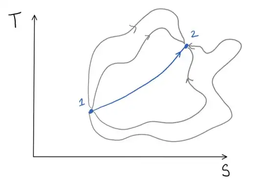

Anyways, you can visualize this statement like this (probably in your textbook): enter image description here
Consider only the blue paths for now, these represent any general process between states 1 and 2. At a given pressure, state 1 is defined by $(T_1, s_1)$. We reversibly transfer heat (entropy) to the system, and arrive at state 2 defined by $(T_2,s_2)$ along the blue path. The amount of entropy we transferred is $\left(\int_1^2\frac{\delta Q_{rev}}{T}\right)_{1}$, where the subscript $1$ declares that this is path Number 1. Now to get back to state 1, go along the blue path again. we must remove entropy from the system, an amount equal to $\left(\int_2^1\frac{\delta Q_{rev}}{T}\right)_2$, again the subscript says I'm calling this path Number 2. The Clausius statement says
$$ \left(\int_1^2\frac{\delta Q_{rev}}{T}\right)_1 - \left(\int_2^1\frac{\delta Q_{rev}}{T}\right)_2 = 0$$
Which obviously says
$$ \left(\int_1^2\frac{\delta Q_{rev}}{T}\right)_1 = \left(\int_2^1\frac{\delta Q_{rev}}{T}\right)_2$$
Now consider the grey paths. By a similar argument, you can see that
$$ \left(\int_1^2\frac{\delta Q_{rev}}{T}\right)_1 = \left(\int_1^2\frac{\delta Q_{rev}}{T}\right)_3 = \left(\int_1^2\frac{\delta Q_{rev}}{T}\right)_4 = \left(\int_2^1\frac{\delta Q_{rev}}{T}\right)_2$$
So, paths 1, 3, and 4 all take you to from state $(T_1,s_1)$ to state $(T_2,s_2)$.
This says that $\int_1^2\frac{\delta Q_{rev}}{T}$ is the same regardless of what path you state to get from 1 to 2. In other words, there are infinitely many ways to add heat (entropy) to your system, and arrive at state 2. This is why entropy is a state function - its value does not depend on the processes required to reach that value.

I added heat at constant volume, and the $T-s$ diagram for this process looks like the blue path here:
But you can see, according to our investigation of the Clausius theorem, that all the grey processes (they might not be constant volume) would take us to the same high temperature state. In other words, there are infinitely many ways to go from a system with low entropy (less jiggling of atoms) to high entropy (more jiggling of atoms) and vice versa.
