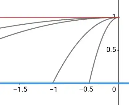

As shown in the figure, the blue straight line is the horizon. This is the horizon without bending. The direction of gravity is parallel and perpendicular to the horizon. The red line is a horizontal straight line. Throw an object horizontally to the left, and the object moves along a parabola under gravity. When the speed tends to infinity, the object moves straight along the red line without free fall.

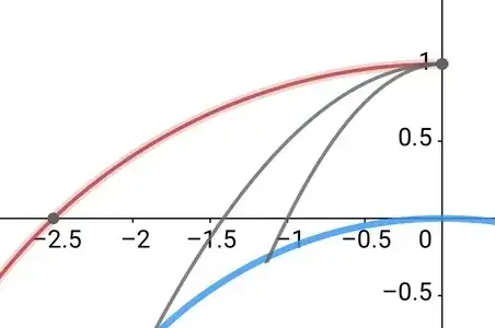

As shown in the figure, the blue line is the horizon, the horizon is curved, and the red line is concentric with the horizon. Gravity is perpendicular to the horizon. In other words, gravity is along the normal direction of the horizon. Throw objects along and perpendicular to the horizon normal, and the objects move along a "parabola". When the speed is appropriate, the object moves along the red line without free fall.
