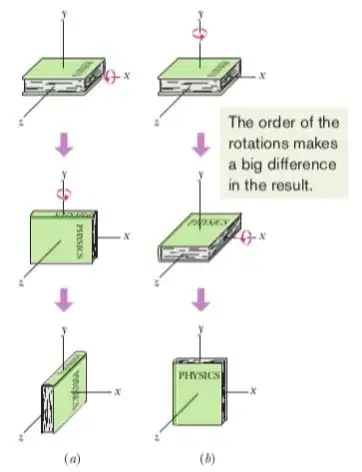

Example of the book: An initially horizontal book is given two 90° angular displacements, first in the order of Fig. (a) and then in the order of Fig (b) . Although the two angular displacements are identical, their order is not, and the book ends up with different orientations.
Book Being Rotated

The key is in the parenthetical statement in your first block quote: focus on the "unless they are very small" part. This can be seen by doing the simple "experiment" below. While this answer is not mathematically rigorous (for the rigor, see @The_Sympathizer's answer), I think it gets at the heart of the idea behind how we can get angular velocity as a vector from angular displacements. This experiment is from a "discussion question" exercise from Sears & Zemansky's "University Physics with Modern Physics" 13th edition:
Although angular velocity and angular acceleration can be treated as vectors, the angular displacement $\theta$, despite having a magnitude and direction, cannot. This is is because $\theta$ does not follow the commutative law of vector addition.
Prove this to yourself in the following way: Lay your physics textbook flat on the desk in front of you with the cover side up so that you can read the writing on it. Rotate it through $90^\circ$ about a horizontal axis so that farthest edge comes toward you. Call this angular displacement $\theta_1$. Then rotate by $90^\circ$ about a vertical axis so that the left edge comes toward you. Call this angular displacement $\theta_2$. The spine of the book should now face you, with the writing oriented so that you can read it.
Now start over again but carry out the two rotations in the reverse order. Do you get a different result? That is, does $\theta_1+\theta_2$ equal $\theta_2+\theta_1$?
Now repeat this experiment but this time with an angle of $1^\circ$ rather than $90^\circ$. Do you think that the infinitesimal displacement $\text d\boldsymbol\theta$ obeys the commutative law of addition and hence qualifies as a vector? If so, how is the direction of $\text d\boldsymbol\theta$ related to the direction of $\boldsymbol \omega$?
The idea is that the angular velocity vector $\boldsymbol\omega=\text d\boldsymbol\theta/\text dt$ only ever deals with infinitesimal angular displacements, so the example in the pictures you have posted are not valid for comparing angular displacement to angular velocity. The infinitesimal angular displacement can be treated as a vector just fine, even if "larger" displacements cannot be.
