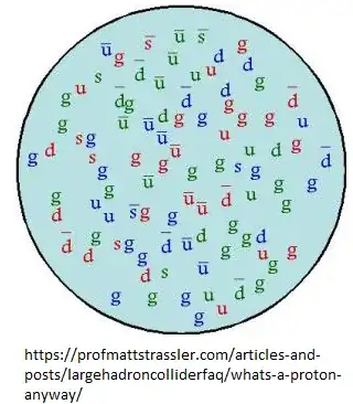

All matter is composed out of elementary particles, in bound systems where there are a large number of four vectors to add to get to the invariant mass of the composite system. Look at how complicated a proton is
myprot
That is why it has a large mass of almost 1000 Mev whereas the constituent quarks and antiquarks have masses of mev and the gluons zero mass. The added four vectors give the mass of the proton ( in a complicated to calculate way)

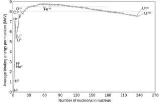

There are quantum number conservation rules that matter composed out of elementary particles has to obey. Charge, baryon number lepton number etc have to be conserved. So one way of turning mass to energy is by annihilation, particle hits antiparticle , quantum numbers add up to zero (by antiparticle definition)and then other pairs of particles and radiation can appear ,taking away kinetic energy. Proton antiproton annihilating even if they have small momenta, create a large number of pions, of course following quantum number conservation.
In nuclear physics because of the binding energy curve of the periodic table of elements ,
binding energy
It is possible to get energy by fission or by fusion of particular elements, which has led to the atomic bomb and the hydrogen bomb. The four vectors representing a nucleus can break up into four vectors of other nuclei and release energy in the form of radiation or kinetic energy of the new nuclei.
