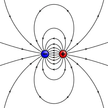

The usual picture used to illustrate this is the electric field lines between two equal and opposite charges placed a distance from each other in free space,
Note how the lines flow out of the positive charge and into the negative charge.
