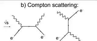

Please note that the concept of "force" comes from classical mechanics. Fortunately there is the definition of force as $F=dp/dt$, $p$ the momentum in the interaction, which is exactly what is needed in Feynman diagrams. Every virtual particle exchange carries a dp/dt, and the four vectors are what are used to calculate the probabilities of any interaction or decay at the quantum mechanical level of particles. example:
compt
There is a force carried by the virtual electron in these two Feynman diagrams.
We do call fundamental forces and assign a gauge boson unique to these , the strong(gluon), the weak , (W and Z), the electromagnetic ($γ$). Gravity is not at this time quantized except only effectively. Usually the lowest order scattering between particles in these forces is with the exchange of the gauge boson.
