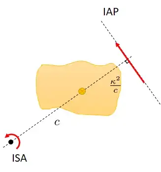

Also in 2D if the ISA of a body is a distance $c$ from the center of mass, and the body has radius of gyration $\kappa$, then the IAP line goes through a point $\kappa^2/c$ on the other side of the center of mass.
IAP
Think about this. For any rigid body, if you know where the ISA is, then you know where the percussion axis is, which means that applying an impulse along the IAP can instantaneously stop the body from moving.

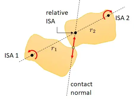

Back to the more specific question of why ISA is useful, well in 2D see this section I authored in Wikipedia about relative centers of rotations and how they can be used to describe the gearing (relative rotational motion) between two contacting bodies.
Since the relative motion of two bodies is also a screw, in 2D the relative motion of two bodies is a point that is colinear to the two ISA of the two bodies.
gear
Consider two bodies in contact, where to contact point is only allowed to slide. Where the contact normal line intersects the line connecting the two ISA centers, is where the relative ISA is. If the distances from the relative center to the two ISA points are $r_1$ and $r_2$ respectively, then the relative gearing between the bodies is $$ \gamma = \frac{\omega_1}{\omega_2} = \frac{r_2}{r_1} $$
