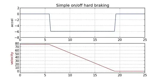

When the brake pedal is pushed, friction causes the car to decelarate. a = some negative number. You can't avoid that. You want to stop? Your velocity must decrease. (Duh.) How my old school bus drive did it

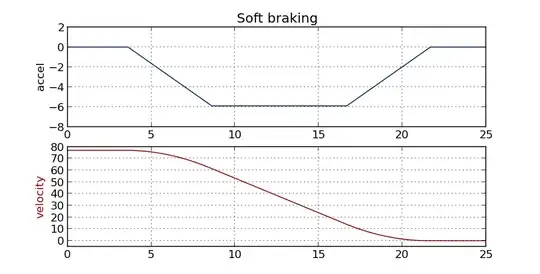

What the passengers feel is the change from a=0 to a=-5.6948 m/s^2 (making up a number.) You want that change to be gradual. Before braking, when a=0, and assuming you're sufficiently skilled and anticipate needing to stop, you light apply brakes. Suppose you make a linearly decrease from 0 to -5.6948, and once there, keep it there. This linear decrease takes place over, let us say, 5 seconds. Likewise, a linear let-up to a=0 timed perfectly as the car comes to a stop.
Remember acceleration is the time derivative of velocity. Velocity, therefore, is the indefinite integral of acceleration, which is a piecewise linear function of time. Plotting velocity vs time, you'd see pieces of parabolas joined together.
Acceleration and velocity during soft braking

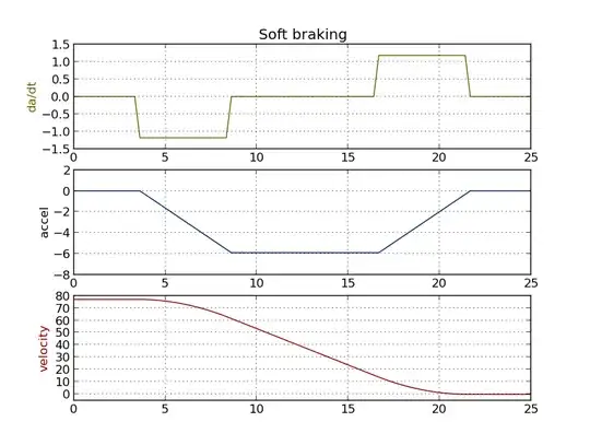

Now, I wonder if passengers would feel the change in acceleration during that time it's changing? It's changing gradually, but it is going from non-changing (zero) to changing linearly, to finally not changing (steady strong braking), with no sudden jumps. Maybe the game is to soften the rate of change of acceleration, to not suddenly go from flat to linear. Look at the time derivative of acceleration - it's all step functions in our example! Same as previous, with rate of change in acceleration also shown

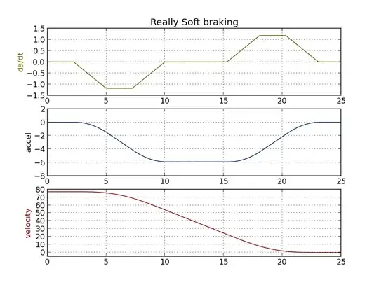

So make the time derivative of acceleration be piecewise linear, no jumps. Then the acceleration is smooth, no sudden changes in slope where parabolas join. Velocity is very smooth, described by 3rd degree polynomials. A good driver/pilot approaches this kind of smoothness by intuitive feel and experience. With continuously varying acceleration

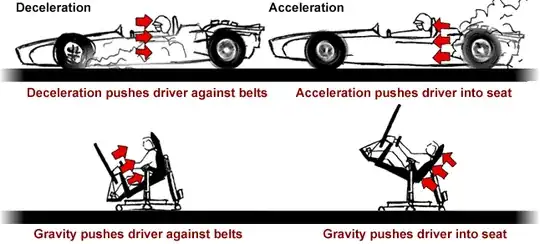

In vertical motion, minimize the rate of change of acceleration (jerk). In an elevator, with different accelerations we have different weights, we feel comfortable at a constant acceleration since at constant acceleration we have constant weight.
In horizontal motion, minimize the acceleration. In a car, we feel comfortable at a constant velocity because of inertia. According to Newton's first law, "If an object experiences no net force, then its velocity is constant: the object is either at rest (if its velocity is zero), or it moves in a straight line with constant speed (if its velocity is nonzero)." [Wikipedia].
Note that both vertical jerk and horizontal acceleration are time dependent. The most beautiful braking ever would, sadly, take infinite time to complete (zero jerk and acceleration). However, this only applies if start out stationarily (or moving in the opposite direction). So if you want to consider optimization problems (e.g. calculate the motion of a vertically moving elevator and horizontally moving vehicle that would be the most comfortable for its passengers) we must set time limits/constraints.
Accelerating in an elevator Accelerating in a car
Note that the person in the seat (gravity pushes driver against belts, etc.) is comfortable because a zero acceleration is also a constant acceleration. Similarly, a passenger of a vehicle (moving horizontally) would feel comfortable when the car is stationary because a zero velocity is also a constant velocity.
