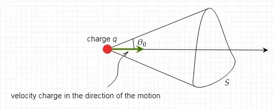

and the direction of the motion of the charge $q$ (supposing an horizontal direction) generate an angle $\theta_0$, the domain $D_{(\theta,\varphi)}$ is as $[0,\theta_0]\times[0,2\pi]$ (hence $0<\theta_0 <\pi$), $$\int_{S}\mathbf{F}(\bar{r})\,\overline{da}=\iint_{D} f(\theta,\varphi) \sin \theta\, d\theta d\varphi=\int_{0}^{2\pi}d\varphi\int_{0}^{\theta_0}f(\theta,\varphi) \sin \theta\, d\theta \color{red}{\neq 4\pi k_e q} \tag 2.$$
What are the possible physical considerations if the flux is different by $4\pi k_e q$ as into the formula $(2)$?
What happen in this situation?

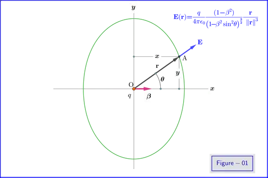

As proved in my above referenced answer, the electric field of a point charge $\,q\,$ in uniform rectilinear motion is given by the following equation \begin{equation} \mathbf{E}\left(\mathbf{r}\right) \boldsymbol{=}\dfrac{q}{4\pi \epsilon_{0}}\dfrac{(1\boldsymbol{-}\beta^2)}{\left(1\!\boldsymbol{-}\!\beta^{2}\sin^{2}\!\theta\right)^{\frac32}}\dfrac{\mathbf{{r}}}{\:\:\Vert\mathbf{r}\Vert^{3}}\quad \text{(uniform rectilinear motion)} \tag{01}\label{01} \end{equation} as shown in Figure-01 (in all subsequent Figures we suppose, without loss of generality, that the charge is positive $\,q>0$). In this Figure for the constant velocity vector of the charge \begin{equation} \boldsymbol{\beta} \boldsymbol{=} \dfrac{\boldsymbol{\upsilon}}{c},\quad \beta\boldsymbol{=}\dfrac{\upsilon}{c}, \quad \boldsymbol{\dot{\beta}}\boldsymbol{=}\dfrac{\mathrm d\boldsymbol{\beta} }{\mathrm dt}\boldsymbol{=0} \tag{02}\label{02} \end{equation} The closed curve shown in Figure-01 is locus of constant electric field magnitude \begin{equation} \Vert\mathbf{E}\Vert \boldsymbol{=}\dfrac{\vert q \vert}{4\pi \epsilon_{0}}\dfrac{(1\boldsymbol{-}\beta^2)}{\left(1\!\boldsymbol{-}\!\beta^{2}\sin^{2}\!\theta\right)^{\frac32}r^{2}} \boldsymbol{=}\text{constant} \tag{03}\label{03} \end{equation} More exactly the set of points with this constant magnitude of the electric field is the surface generated by a half revolution of this closed curve around the $\;x\boldsymbol{-}$axis or a half revolution around the $\;y\boldsymbol{-}$axis.

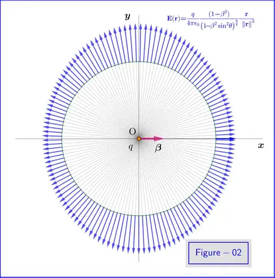

In Figure-02 above it's shown the electric field on a circle, that is on the surface of a sphere generated by a half revolution of this circle around the $\;x\boldsymbol{-}$axis or the $\;y\boldsymbol{-}$axis. We note that the field is always normal to the spherical surface and get stronger as we approach directions normal to that of the motion of the charge.

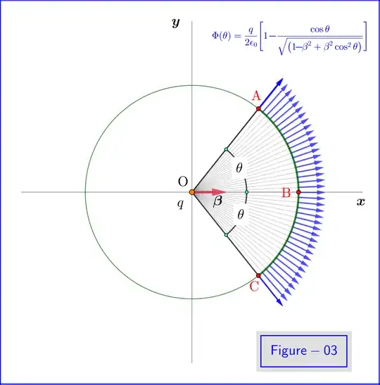

In Figure-03 above it's shown the electric flux through the circular arc $\rm ABC$, that is through the spherical cap generated by a half revolution of this circular arc around the $\;x\boldsymbol{-}$axis. As proved in my referenced answer in the beginning, the electric flux is given by the following equation
\begin{equation} \Phi\left(\theta\right)\boldsymbol{=}\ \dfrac{q}{2\epsilon_{0}}\Biggl[1\boldsymbol{-}\dfrac{ \cos\theta}{\sqrt{\left(1\!\boldsymbol{-}\!\beta^{2}+\beta^{2} \cos^2\theta\right)\vphantom{\frac12}}}\Biggr] \tag{04}\label{04} \end{equation} For $\theta\boldsymbol{=}\pi$ we could verify Gauss Law \begin{equation} \Phi\left(\pi\right)\boldsymbol{=}\ \dfrac{q}{\epsilon_{0}} \tag{05}\label{05} \end{equation}
