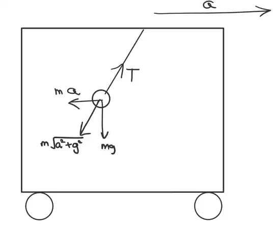

In the frame of the cart a pseudo force acts towards the left. Notice that this is the new equilibrium position of the bob: enter image description here

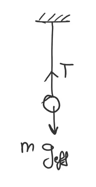

Now, let us turn the axis of the drawing so as to make it easier for us to understand.
Here $g_{eff} = \sqrt{a^2+g^2}$

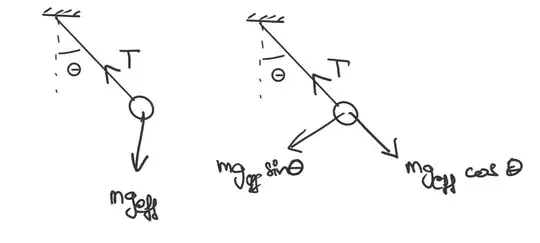

Now, we take a small angular displacement of $\theta$ and analyse the motion. enter image description here
We get: $$ \tau = mg_{eff}l\sin\theta\\ $$ But, $ \theta << 1$ $$ \tau = mg_{eff}l\theta\\ $$ So, we get, $$ C = mg_{eff}l\\ and\ I = ml^2\\ $$ Finally, for time period, $$ T = 2\pi \sqrt{\frac{I}{C}}\\ T = 2\pi \sqrt{\frac{ml^2}{mg_{eff}l}}\\ \implies T = 2\pi \sqrt{\frac{l}{g_{eff}}}\\ \implies T = 2\pi \sqrt{\frac{l}{\sqrt{g^2+a^2}}} $$ Hope this helps!

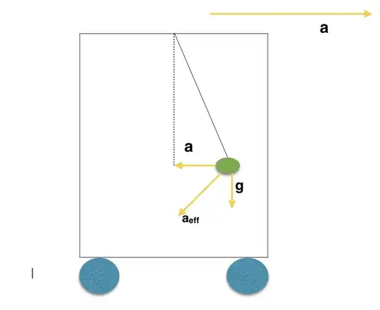

That's because of Pseudo Force (Fictitious Force) acting on the bob as you're considering an accelerated frame. Along with earth's gravitational force acting on the bob, there is another force called "Fictitious force" acting on the bob whose direction is opposite to the direction of the accelerated frame of reference. So, it's no more just $g$ rather it is the vector resultant of $g$ and $a$, where $a$ is the acceleration of the frame. The magnitude of the resultant is $\sqrt{a^2 + g^2}$ which is $a_{eff}$.
