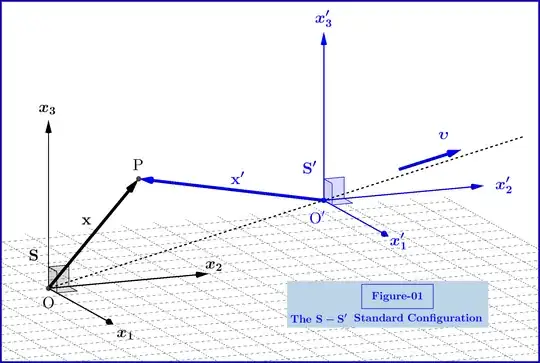

Now, to see how the angular momentum is transformed under a Lorentz transformation let an inertial system $\,\mathrm S'\boldsymbol{\equiv}\mathrm O'x'_1x'_2x'_3t'\,$ translating with respect to the inertial system $\:\mathrm S\:$ with constant velocity \begin{align} \boldsymbol{\upsilon} & \boldsymbol{=}\left(\upsilon_{1},\upsilon_{2},\upsilon_{3}\right) \tag{04a}\label{04a}\\ \upsilon & \boldsymbol{=}\Vert \boldsymbol{\upsilon} \Vert \boldsymbol{=} \sqrt{ \upsilon^2_{1}\boldsymbol{+}\upsilon^2_{2}\boldsymbol{+}\upsilon^2_{3}}\:\in \left(0,c\right) \tag{04b}\label{04b} \end{align} as in Figure-01.
The Lorentz transformation is \begin{align} \mathbf{x}^{\boldsymbol{\prime}} & \boldsymbol{=} \mathbf{x}\boldsymbol{+} \dfrac{\gamma_\upsilon^2}{c^2 \left(\gamma_\upsilon\boldsymbol{+}1\right)}\left(\boldsymbol{\upsilon}\boldsymbol{\cdot} \mathbf{x}\right)\boldsymbol{\upsilon}\boldsymbol{-}\gamma_\upsilon\boldsymbol{\upsilon}\,t \tag{05a}\label{05a}\\ t^{\boldsymbol{\prime}} & \boldsymbol{=} \gamma_\upsilon\left(t\boldsymbol{-} \dfrac{\boldsymbol{\upsilon}\boldsymbol{\cdot} \mathbf{x}}{c^2}\right) \tag{05b}\label{05b}\\ \gamma_\upsilon & \boldsymbol{=} \left(1\boldsymbol{-}\dfrac{\upsilon^2}{c^2}\right)^{\boldsymbol{-}\frac12} \tag{05c}\label{05c} \end{align}
