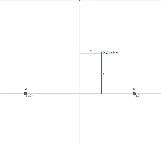

Two massive bodies of mass $M$ are fixed at the positions $\vec{A}=(d, 0)$ and $\vec{B}=(-d, 0)$. setup
Now imagine a test particle $p$ with initial position $\vec{r}_0=(x_0,y_0)$ and initial velocity $\vec{v}_0=(0,0)$. Its position $\vec{r}(t)=\left(x(t),y(t)\right)$ will change over time under the influence of the gravitational potential. If the test particles trajectory goes through $A$ (or $B$) the initial position $\vec{r}_0$ lies in the basin of attraction of the mass at point $A$ (or $B$).
Question: Does $x_0 \gt 0$ imply that $p$ will eventually come arbitrarily close to $A$ (and not $B$)?
Or simpler yet: Does $x_0 \gt 0$ imply that $x(t)\gt0$ for all $t$?

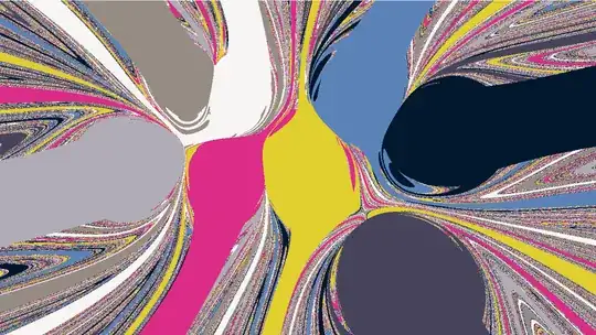

Example of basins of attraction of many bodies
Here are some more examples: 1, 2, 3, 4*
As you can see the basins are generally fractals.

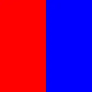

Yet, when I simulate the above described setup, where $n=2$ and the masses of the two bodies are the same, the following picture is produced.
basins for two bodies
Where blue pixels represent initial positions in the basin of attraction of the mass at point $A$, red pixels those in the basin of the mass at point $B$ and black pixels in neither. (A thin strip of black pixels lie on the line $x=0$, where they oscillate around the origin)
The picture is clearly devided into two half planes, yet I can not explain why. Any help explaining this fact would be much appreciated.

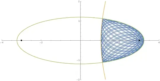

It turns out $\mu$ and $\nu$ completely decouple, and basically look like two harmonic oscillators (up to a coordinate transformation)! If the two oscillation periods are incommensurate, as they will be for generic initial conditions, the particle will ergodically fill the region it is energetically allowed inside, coming arbitrarily close to any point inside of it, including the massive bodies themselves. This agrees with my simulations, an example of which is pictured. Here the blue line shows the trajectory of the particle, and the green and orange lines are curves of respectively constant $\mu$ and $\nu$.
Trajectory of test particle
The part corresponding to $\nu$,
$$ \mathcal{H}_\nu' = \frac{p_\mu^2}{2a^2} - |E| \cos^2 \nu , $$
implies that $\cos^2 \nu > \cos^2 \nu_0$. Since the half-plane $x = 0$ corresponds to $\nu = \pm \frac{\pi}{2}$, where the cosine achieves a minimum, this also proves that a particle starting with zero initial velocity will be confined to its own side.

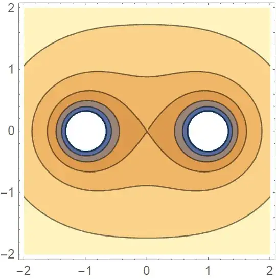

The equipotentials look like
For a particle starting from rest, the contours also represent the level curves of the first constant of motion, total energy $E$. Each point on the contour represents a starting point for a trajectory. In addition, a trajectory can't leave the interior of the contour. Since the contours for $V\le-2$ (the "$\infty$" curve) don't cross over to the other plane, for trajectories in these regions with $|x|>0$, $E$ alone segregates the basins into different plains.

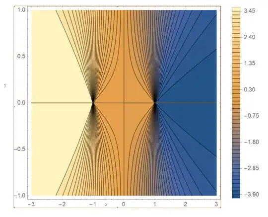

Now consider the second constant of motion,

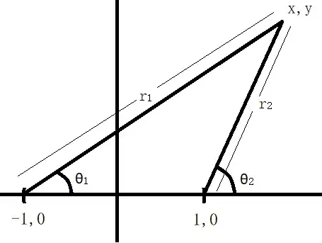

$R=r_1^2r_2^2\dot{\theta_1}\dot{\theta_2}-2(\cos\theta_1+\cos\theta_2)$
where the symbols are as as in- enter image description here As before we plot the level curves for this constant and see what they look like. enter image description here Each curve indicates a starting point of the trajectory.Each pair$(E,R)$ uniquely identifies the entire trajectory.
We observe that,$R$ seems to divide the starting points into 3 classes:
$R\gtrless0$ corresponds to $x\lessgtr0$.
with $R=0$ implying $x=0 $ or $(y=0,0<|x|<1)$. So trajectories starting in the right half-plane never enter the left as this requires a constant of motion to change sign. The $R=0$ with $(y=0,0<|x|<1)$ is explicitly checked and found also to satisfy the above.
Since the equipotential bounds the trajectory on the right, the particle is doomed to meet its corresponding source of field.

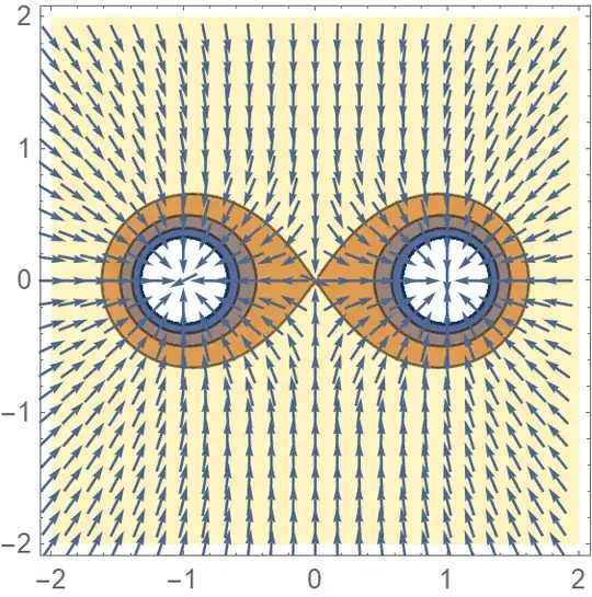

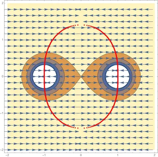

Now consider the field plot for the direction of the horizontal component of force
Trivially, the answer is affirmative for $y_0=0$ as y component of force vanishes.
The red dots(numerically calculated) indicate the boundary (excluding $x=0$), say $B$, where the horizontal component switches sign. Within this region, the particle always moves away from $x=0$.
If we could show that the particle never crosses B, then all such trajectories must terminate. Since the only point of singularity for these would be the mass location so answer be in the affirmative for these points too.
Alas! this isn't true.
So instead,
If we can show that the particle never crosses $y=\pm m x$ where $m=y_0/x_0$ and $0<x<x_0$, the basins would indeed be half planes. This seems to be indicated by sims.

The $R$ being used is
where the parameters are as indicated in the main answer above.

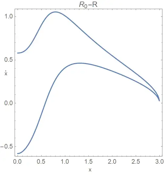

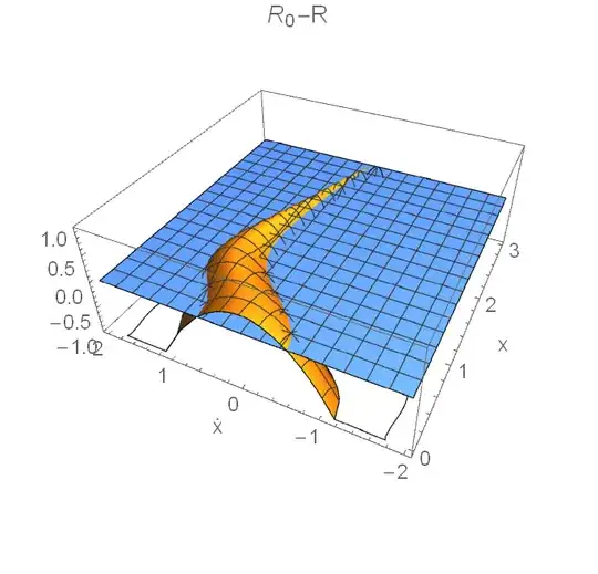

Currently, this procedure seems to fail. e.g. for $m=1, x_0=y_0=3$, here's what the plot is:
enter image description here (the blue plane is $R_0=R'$) So for the following $x,\dot{x}$ values enter image description here
there seem to exist values $(x',\dot{x'})$ for which, the trajectory swivels back to the line.
However, we should note that the existence of a negative $\dot{x}$ can't alone imply crossing as some large value of ${\dot{y}}$ may still keep the trajectory inbound.
