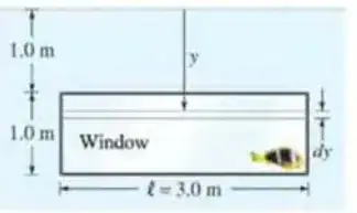

In a hydrostatics problem, we want to get the force due to water pressure at a window of a parallelepipedal acquarium
It's found that the force on each horizontal strip is $dF=PdA=\rho gyldy$, which is later integrated to yield:
$\int dF =\int_{y_1=1}^{y_2=2}\rho gyldy $
$ F= 1/2\rho gl(y_2^2-y_1^2)$
and again they just argue that the total force is the sum of the small contributions, but I wonder why isn't it
$\int dF = F(y_2)-F(y_1) $ , instead of $\int dF = F $ on the left-hand side?
