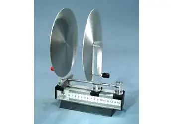

A simple capacitor can look astonishingly like it's schematic symbol. But as long as there's a wire from one plate, through a resistor, and back to the other plate, any "series capacitance" is shorted out by the wire. The wire (and resistor) on the other hand, are electrostatically coupled to ground (and to everything else in the universe; eventually you might have to pay attention to that).
So it's not so much that the stray capacitance is assumed to be in parallel, it's that it's pretty much determined to be, if not proved, by the fact that there's a DC connection from each plate of the capacitor to the resistor (possibly through a battery or other power supply).
